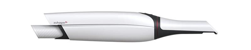

Back in 2017, 3Shape rocked the dental industry by releasing the world’s first and only wireless intraoral scanner. Four years later, two more intraoral scanner makers joined in by introducing their own wireless models to the market.
Wireless intraoral scanning has certainly made an impact. Professionals rave about the benefits of not having a wired connection to the PC: no cable draped across the patient; no more accidentally pulling the scanner off the table, and improved ergonomics when scanning.
