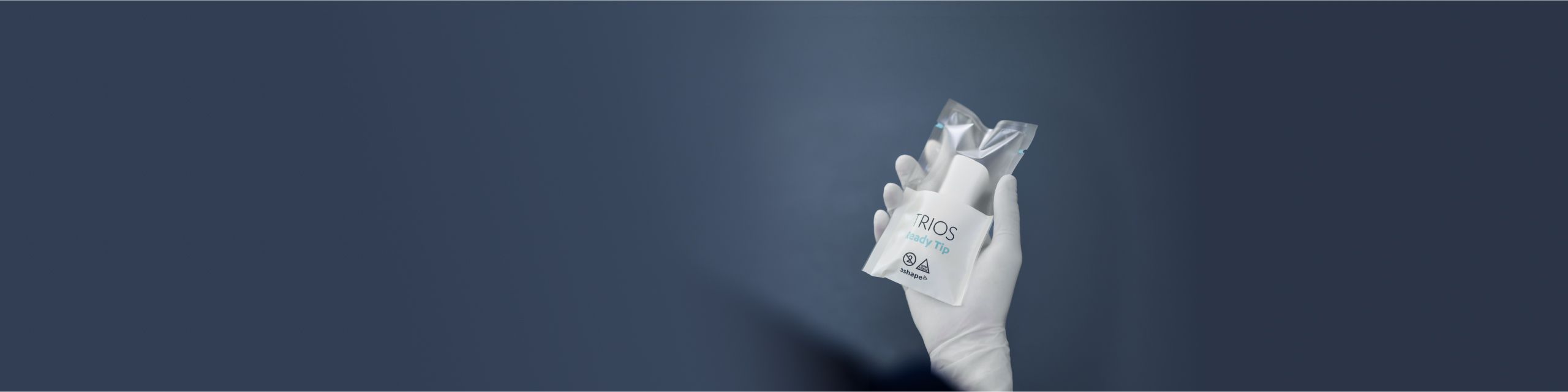

Are the TRIOS Ready Tips sterile?
TRIOS Ready Tips are hygienic but non-sterile. Each tip comes in a hygienic sealed package and is ready for use immediately.
